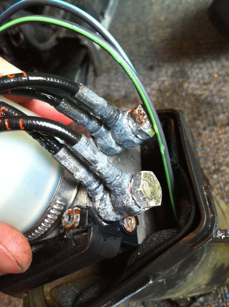

Well, finally me and my friends did the change on the motor, and thought I would post the pics of the motor condition.
the new motor by the way was the same as the old one.

Thanks so much for the quick reply! Will do this now and report back in a few hours. Also going to post some pics of my old motor. I can't believe just how bad it looks!
