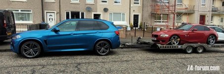

Hi Group, new to the forum. Recently brought my Z4M out of storage as its been off the road for a few years. Car requires full repainting due to my own mishap in the rain. Bought new front and rear wings, genuine from BMW, and fitted these as the damage wasn't major. Unable to see in the photo as its the drivers side, these are still in primer.
Using my X5M to tow the Z4M here, just went into M3 Motor co in West Lothian to begin the mechanical part of the restoration then onto full window out respray at BM Autodesign. Currently bought a full supersprint race exhaust which I'm waiting on coming from Italy. This includes the stepped headers, sports cats, X pipe and race rear silencers. Big plans for this car as will be adding all the upgrades I originally had in mind for the car when I bought it back in 2013.

X5M and Z4M combo, getting common now :lol:
Just need to add one dark blue M car to complete the M-colour triad. :lol: Welcome to the forum!

I hope you keep us updated with progress - Imola Red is my favourite colour for an MC!
Ha ha DMike, I never thought of that, but your right. Better not mention this to the misses. :rofl: I do have a black R53 Mini JCW 210 thats pretty nice also. I Like to think I now have one of the best NA engines, a twin turbo V8 and a Supercharged go kart. The holy trinity. :lol:
