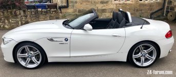

A photo of your pride and joy would be nice and also one of the weather strip.

Cars looks great in white. It’s hard to see what’s splitting from the photo, have you tried some rubber conditioners on them, something like gummi-pfledge or a rubber o ring grease, it may help to stop it getting any worse.
