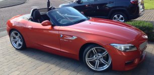

One wash, one machine polish (removed 90% of swirls at first attempt) and two coats of wax all done between rain and hail showers requiring being put in and out of the garage several times.
Quite pleased with the results. :D

Looks good - the bonus is a sense of satisfaction of a job well done too! Similar plans for me today, hope mine looks as good!

One thing I did notice after the machine polish was how much the 'metallic' aspect of the paint appeared to be more apparent.
