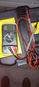

You need a good multimeter to check battery voltage. There could be a battery drain, or the alternator is not supplying enough current. Consider a bad earth.

I'd be checking the static voltage and the voltage with the engine running. It sounds like it isn't charging properly which may be a bad earth as raymond said, a dying alternator or you've got a parasitic drain.
So I drove the car 40 minutes to work yesterday, and about 45 minutes home again. All seemed fine. 5 minutes after parking up in the evening, battery was at 12.40 volts.
Car has sat for 24 hours, and is now showing 12.14 volts.
My hunch is that its just a crap battery
12.40 is low for a fully charged battery; it may not have had sufficient time to get a charge. The voltage loss for 24 hours is acceptable. If possible, give the battery a trickle charge overnight to rule out a duff battery.
