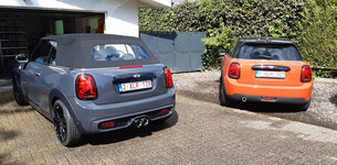

they are superb cars, i've had a manual F57 Cooper S, and there a lot of fun indeed ...
I've sold the grey for (again) a E89, but my wife drives the orange Cooper . :driving:
