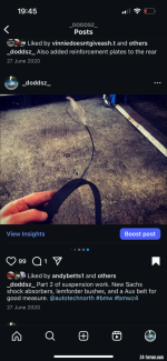

This was mine a canny few years ago somwhere between 74k-90k miles can’t remember exactly
The OFH oil seal can leak onto the belt causing it to slip off / shred as did mine coming across the M48 Severn Bridge. Battery lasted about 15 minutes.
