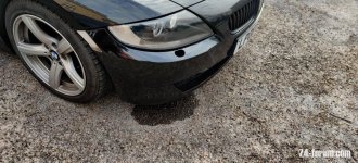

On the odd occasion since January my car has had the fan on full tilt at start up, almost always when the car is fully warm. Goes off after a few seconds or if the car is restarted.
Recently this issue has come much more to the front of my mind. Sounds and looks waterpump related to me but wanted to ask here as I'm still very new to bmw.
A few weeks back a colleague told me that I had a leak, when I went outside I noticed that my car a small puddle under the front drivers wing, directly under the fog light. Checking the coolant it was a little low ( no light) so I replaced a few ml of fluid and then drove the car home. No coolant loss occurred and no leak seen.i had covid and was badly for a month or so and the car wasn't used other than a 1000 yard trip to the shop.
I drove it to work yesterday and noticed that the heaters didnt get fully hot on my return trip. Still no coolant loss in the tank but a small puddle appeared on the drive over night. I test started the car this morning and the fan was going full throttle so I turned it off and stole the Mrs golf.
Is this likely to be the dreaded pump or is it possibly a radiator etc? The coolant leak isn't near the pump, it's about 1ft further forward.
I'm not sure about the issue you are having with the fan, but looking at your photo you seem to have lost the headlamp washer! That'll be where the fluid is coming from.
If your electric water pump is dying the temperature gauge usually goes way up pretty quickly, and there should be a fault code stored in the OBD so getting those read would be worthwhile.

Its been missing well over a year, never had this issue. I have used the washers on the trip, so possibly. Ill try and dye the washer fluid and see if it is screen fluid.

If it is washer fluid you should be able to tell by checking the level in the reservoir.
When I picked up my current car the fluid level warning light was on. When I got home I filled it and the next day there was a big puddle at the front corner of the car - that's when I realised the headlamp washer was leaking!

Are there any common leak paths in that area? Its certainly coolant.
