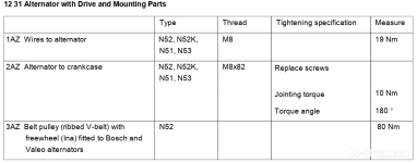

I don't think it's mentioned in that video but the alternator mounting bolts are aluminium and should be replaced.
Part number for replacement set of bolts is 12310392568
