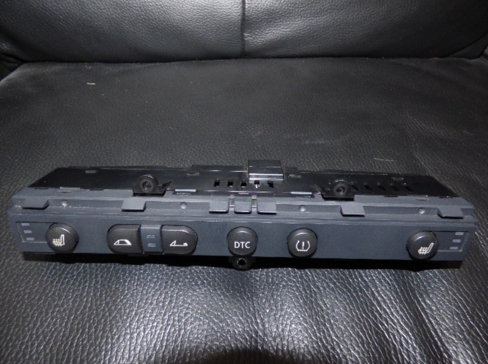

Although the seats have the heated elements, my face-lift Zed isn’t pre-wired for heated seats, and so began the search for wiring looms and a centre console with additional switches. I managed to find a centre console fairly easily on eBay, but the wiring looms were a different matter! BMW no longer sell retrofit looms for the facelift Z4, and I found it impossible to source second hand ones from breakers :headbang:

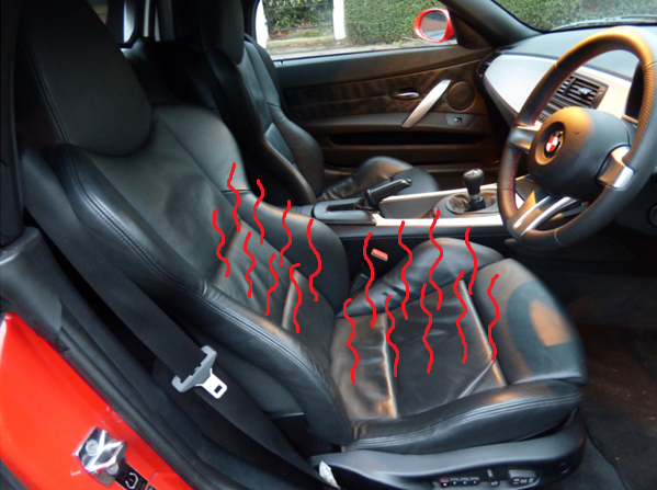

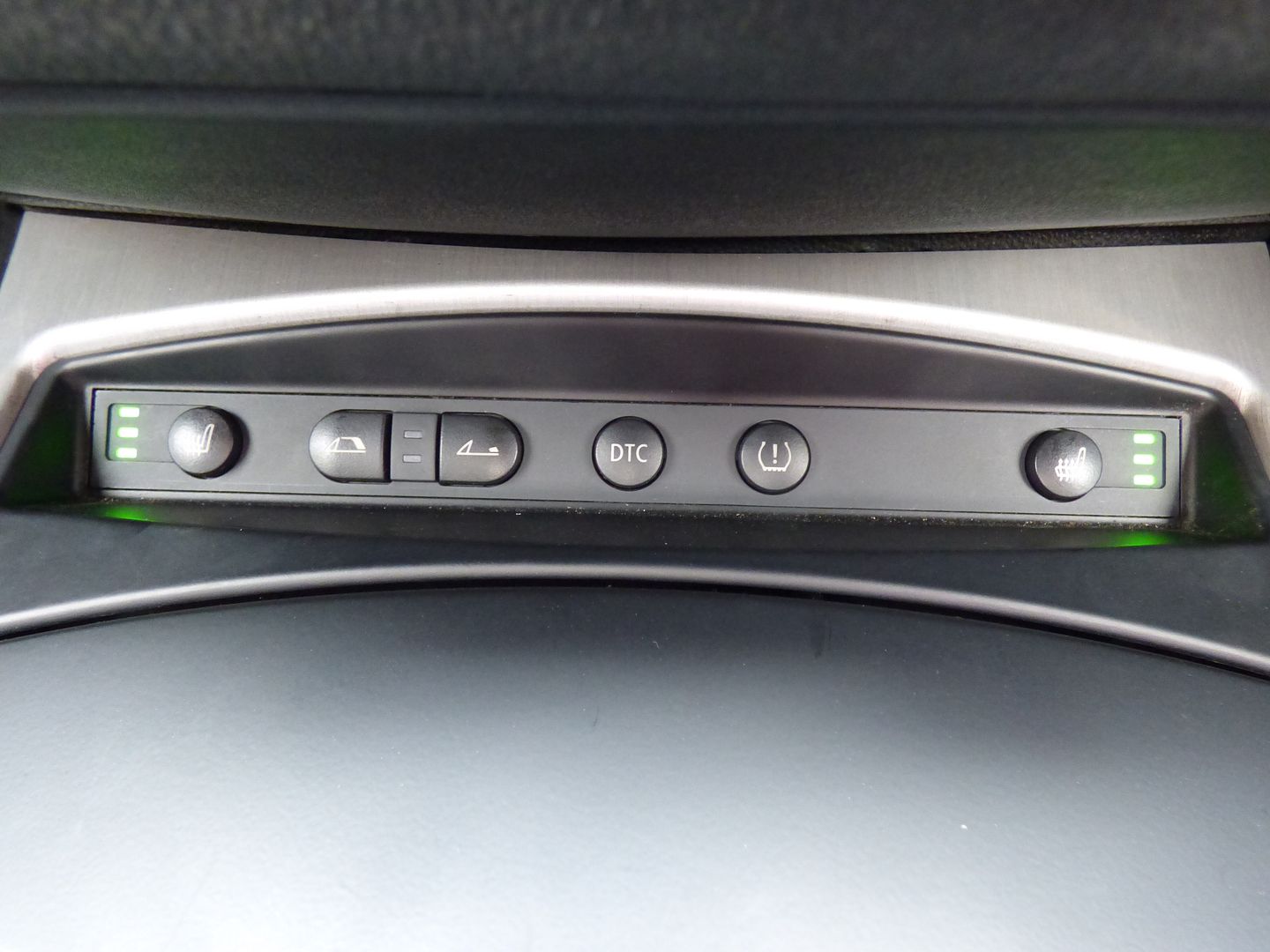

I now have heated seats :dance2:
Apparently the looms went in fairly straightforwardly, apart from the usual faff of having to dismantle half of the interior.
Huge thanks and respect to Fishy Dave, without whom this would not have been possible (details earlier in thread).
It took a long time and a lot of effort but was worth it.
I drove back from the garage with roof down and seat on full - I'd forgotten just how toasty hot they get :D
