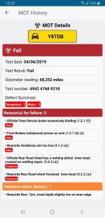

Well being a 3.0 it’s probably a good time to do a 330 brake upgrade. Otherwise if you’re in a pinch you can take my O/S front caliper. Removed it from mine because my N/S was binding badly. The irony lol!
Headlight just needs adjusting, should be the most simple.
Wheels... happens more because of runflats! Just get a new set with tyres from eBay or something? Upgrade to 224’s?
Good luck with it!
Thanks for the caliper offer, appreciate it :thumbsup:
It's all not too bad actually. My garage is very helpful, their wheel place is going to check the rears over and if fixable, £58 plus vat each. Agreed, if they can't be repaired I'll look out for a set with non run flats on. Plenty around but I do love the elipsoids!
Headlight not a problem as you say - this was the only one I was expecting as the alignment was way off after fitting the facelift headlights.
The car has been juddering when breaking for a while now, got worse recently to the point where it's been spoiling the drive. I got hold of a freshly refurbished full set of calipers/carriers for a decent price at the weekend, so the timing is actually useful - hopefully the new set will sort the braking issues out, and I've bought new discs and pads all round (the fronts are warped) as Euro Car Parts had a 50% flash sale today.
So, more expensive than I was hoping, but no disaster.
Onwards and upwards :D

MOT progress update....
The rear wheels were condemned, so that's a work in progress. The re-test window expires tomorrow so I'll have to pay the full fee either way, no desperate hurry for the wheels other than I can't drive the car - but given the current weather that's no disaster :D
Some slivers of good news. Headlight adjusted, refurbed silver calipers fitted and all working correctly - they look nice too, far more subtle than the red. On the albeit very short journey back from the garage all the old braking issues are resolved (hurray!) and the garage said as soon as some new wheels go on, the MOT should be fine.

MOT passed today - wow, that was painful.
I bought 3 replacement elipsoids from Ebay, my garage said one was unusable due to being so out of shape (dents all round - shaped like a 50p :D) and the other 2 were so badly corroded that they wouldn't reliably hold air :headbang:
So, 2 of the 3 replacements hastily refurbed (which look lovely - just more unplanned expense), 2 rear tyres swapped over from my knackered wheels, back in for the MOT today, finally success. They even took pity on me and gave me a reduced MOT rate :rofl:
Worst MOT for a number of years, but considering what was covered the overall cost wasn't too painful in the end and leaves the car in very good shape. I'll always remember taking my hateful Honda Accord in for a 'routine' service and MOT a few years ago (long since sold thankfully) - which similarly resulted in new discs and pads all round - and leaving £1300 lighter.
