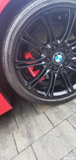

I have MV2s on mine, I do like the look of the MV3s, less to clean ๐Ÿค”๐Ÿ˜
