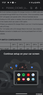

@anubiszed - can I change the VO value with bimmercode, do you know? What is that value?
Alas I don't work with Bimmercode, so I don't know how it operates, hopefully someone who does can explain better.
But if you didn't have the multiple CD positions before, and you do now then I'd say you've done something with the VO already.
Just to check, you have done tge following:
Disconnected the Pink LVDS plug from the rear if the headunit and plugged it into the new Y LVDS, and the plugged the other end of the new LVDS cable (greeny blue) into the pink socket of the headunit.
You've unplugged the MOST connector from the old Quadlock connector, then having swapped it into the new MOST Y jumper, plugged the new end into the new Quadlock in the rear of the headunit?
So as your phone can see the Mr12volt box then you are obviously using the new Quadlock Y loom, as this is powering it, so I was wondering if you'd missed some connector out somewhere (as questions above)
