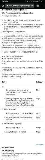

And in the CURRENT testing manual..
Fogs ARE mentioned, albeit only for newer cars.
Mike
Mike
I stand corrected, we live and learn :thumbsup:

But only on cars registered 1st March 2018 onwards by the looks

I also stand corrected, although from reading that, testing of front fog lights won't apply to any cars for another 2 1/2 years.
Thats interesting I have literally just come back from the MOT station (pass with no advisories!!!) and had the front fog lights tested on my car. I mentioned to the tester that they had never been tested before and I remember him saying that it was part of the new testing regime. So presumably he was wrong as the guide clearly states, cars first used from 2018. I wonder if there is any wriggle room for the tester, perhaps they routinely check them all and would in the event of a failure only issue an advisory for pre 2018 cars.
