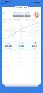

For reference. This is my remapped 20i… 5.13 seconds with a slight incline.
That was on a mildly damp road with 225 width winter tyres. I suspect one I get my 265 width summers installed I should be able to get it under 5 seconds as I’ll be able to brake-boost more.
