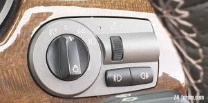

This is an LCM for a car with Xenon headlights. Seems like smorris is on the money with thinking your car had, at one point, xenon headlights.
That's what my LCM looks like except just one button for the fog lights.
That dial is just for the interior dash lighting, though.... What are you saying is the headlight adjustment?
I can't help you any further bit it seems like you have the wrong LCM for the headlights you currently have.
Hopefully smorris will be back in a bit to give better advice.
