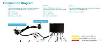

Quick question... again to AnubisZed.
Got my set up ready to go, just finding time..... The people at Andream suggest the following A# to B#, but I know your setting is with L# to B#, which works. What's the difference?
I've seen several versions of their manual, all different :) and none of them suggest L# to B#. Not doubting your video info at all, just curious.
Closer inspection shows A# labelled "Low Can", B# is high Can :? ?

Choices choices.......
Attempt 6 at typing this, now resorting to my phone as the forum keeps kicking me off the page after typing the answer!!!!
In short, as I cant be bothered to write that all again, I simply don't know. I do know that L to B works, and I've found this out by trial and error.
Wish these manufacturers put a bit more effort into explaining stuff.

By the way, A# connected with B# works ok, strange they have 2 CAN connections which do the same thing.
