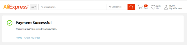

You've inspired me.. order placed. I might not be so enthusiastic when it comes to doing it :cry:
