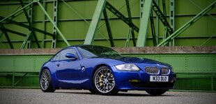

This is the ownership thread for my Montego/Champagne Coupe.
Previous z4-forum owners:
Z4Pilot (Sean) 2015 > 2020
Tuck411 (Rich) 2020 > 2023
Latest:
Initial observations (bad points, if you wish) upon inspection:
Oil filter/cooler gasket is a little weepy. DONE
I want to swap out the wheels for 18's. DONE
The carbon lip boot spoiler is not to my tastes, that will be removed. DONE
Replace the aftermarket stero with the original. DONE
Replace the black grills with the originals. DONE
I get arch liner contact on deep road undulations. Changing back to OEM springs should sort. DONE
Front bonnet badge is peeling and scruffy. DONE
A teeny tiny bubble has formed at the bottom of the drivers rear wing, it's very small, but there. DONE
Water pump, thermostat and 'Micky Mouse' flange need doing, preventative. DONE
Headlight perspex needs a polish and seal, a little cloudy on the top edge. DONE
The 2nd key is playing silly beggers, sometimes it works, sometimes not. DONE
Flickering interior LED bulbs. DONE
Needs oil service. DONE
Ohh and, I need to build a car port.! DONE
