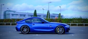

Meds 3.0si Coupe - Rear brake upgrade in progress.

The side reflectors were painted using the left over paint from the wing, what a difference having them painted has made, It looks much sleeker now, those reflectors really stood out (actually, I can't blame them, that's what they're supposed to do :rofl: )
Awesome looking coupe! Nice mods everyway.
Thats brakes looks totally awesome!
