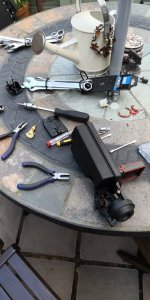

Update 6... 4:15pm
Sat at the garden table with my disa unit. I had to remove the top half of the airbox and piping to get at the bottom T30 screw, which was mildly annoying.
Thankfully it certainly seems like my unit hasn't been upgraded before so this should be worth doing.
It's taken a lot of work to get the pin out and now the old bits are absolutely trashed after struggling to get them out!!!
Update 7... 4:30pm.
F**K THIS "O-RING"!!!!! The factory orange stuff is totally and utterly bonded to the plastic and is coming off in bits. What a faff.
Update 8... 4:57pm
IT IS RAINING. WHY. IS. IT. RAINING.
Have finally got the disa unit back together and am absolutely done with it all now. I don't really want the engine bay open to the elements so the complete and refreshed disa unit is now in the shed until tomorrow where I will pop the bonnet for the last time to install that and the final bolt from BMW.
