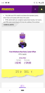

These ones
https://www.powerflex.co.uk/products/Z4M%2BE85%2B%26%2BE86%2B%282006-2009%29-3169/1.html
So yes apologies I mean the z4m ones if they will fit. I'm sure I read somewhere that they increase cornering stability but reduce how quickly the wheels self centre?
I'm sure there's some out there that are already inserted into the lollipop, that would be ideally what I'd get, less messing about.

The Z4M part numbers are:
left bush with carrier: 31107836862
right bush with carrier: 31107836863
bush only: 31107838575
They are narrower and stiffer than the stock bushes. Here's a pic:

So if the carriers are thinner, would I be right to assume that buying the powerflex inserts to put into the existing carriers wouldn't work? Or am I being daft??
Powerflex do an eccentric Bush. Photos in my build thread. You can also buy small lollipops with the same M3 dimensions.
LittleZ4 said:
So they fit! Always a good start :thumbsup:
Bushes are thinner (narrower), carrier is the same.
