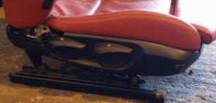

Is this the standard adjustment on an M Sport seat ?
I'm looking to upgrade my SE seats for M sport versions , I'm assuming everything will plug in ?
Although the seat in the picture appears to be manually operated ? My SE seats have Electric tilt and forward and back movements
If I retro fitted M sport seats this style would I get any errors thrown up for missing switches etc ?
There should be 2 handles/levers at the front of the seat also, one should be visible in that pic but I cant see it.
Yep there is 2 handles at the front too, so I take it this is a normal M sport seat then ?
Wasn't sure if this was a basic M Sport seat and there were extra electric options you could pay for to make all adjustments Electric ?
This. There is a manual version and an all electric version. The manual version will however still have a switch on the lower from corner to inflate the bolsters.
Yes it should just plug in, but if you had the memory /heated seats I think it might expect that module to be there..
