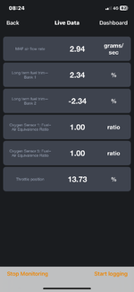

Hi all. On my z4 e86 3.0si that I’ve just gotten about a month ago I’ve been having a strange lumpy idle upon starting both hot and cold that then smooths out after about 30-60 seconds. I wouldn’t say it’s very rough only slight but still unusual. Also tried starting with no MAF and becomes smooth. Is it conclusive to suspect MAF is bad? Also no codes being thrown to Carly.
Check your fuel trims (4 of them) to see if the car is running lean. If it is, then smoke test it to find the vacuum leaks.
Your screen shot shows the long term fuel trims but not the short term fuel trims.
Some vacuum leaks are small enough for the engine DME to manage when in closed loop control (when the engine is hot). They cause misfires when the engine DME is in open loop control (when the engine is cold).
So, we are trying to see if you have evidence of a vacuum leak.

Okay il try this. Thanks. If I remember correctly when I pressed on throttle the values for AFR did change for split second then corrected back so that may hint. It’s all quite unusual and the car by no means drives ‘bad’ but I’m sure there’s something up
