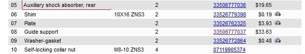

So calling around a few places I'm being told the rear mounts for 3.0 E86 are specific to that car and I cant use the ones from a 3.0 E85.
Is this true?
Being quoted £30 each for OEM only part for the rear mounts and £18 each for Meyle fronts and £22 each for Lemforder fronts.
I was always under the impression the E85/E86 shared the same suspension components.
According to RealOEM.com the part has a unique part number that was only used on E86.
I went for powerflex poly versions on mine but they are a bit firmer ride
Yep, thats exactly the part number I was given, I'm assuming I can use parts no: 9, 10 and 11 that are already on the car.
