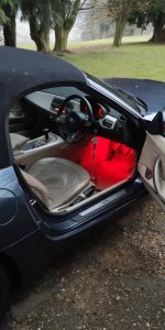

Hi All,
I want to add to the mood lighting in my e85. I've obvious got the factory fitted red spot light that shines down onto the gearstick area. I want to add some red strip lights into the footwell on each side. I've ordered some strip lights but it would be a huge help if someone could point me to where I need to splice the power cables into? I'd like them on all the time that the factory fitted one is on, so guessing I need to tap into that somewhere, but where? Any help hugely appreciated!!

You're a star! Just had a go and had all that trim off in minutes! Just got to figure which cable powers the red led Spot lights now and splice into it with connector blocks!
One side done, I'll get the passenger side done tomorrow all being well. The light looks brighter than it is in the photo, I guess cos it's getting dark and my camera is staying open longer....
