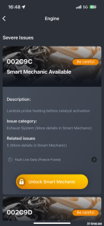

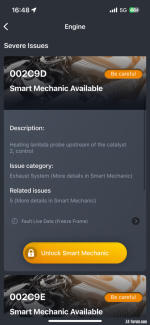

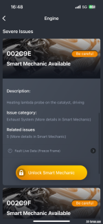

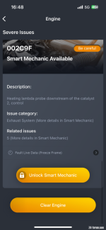

Had the engine light come on today. Was running fine but when I did a scan it came up with 002C9C, 002C9D, 002C9E, and 002C9F.
Has anybody else had the same? Is it a case of needing to replace the sensors, or is there something else worth checking on first?
