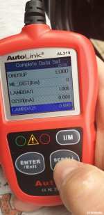

Edit gave it a few revs on drive today and all sounded normal... no error codes have come back on

If your code reader will show you live data, you can start confirming that each sensor is responding as it should. Get to know what good data looks like and compared it to the data you see when the fault occurs.

Car is a coupe 3.0 2007 reg. I dumped a pic of the live data above but there is literally pages of the stuff so if you think anything useful to screen grab let me know and il do it
