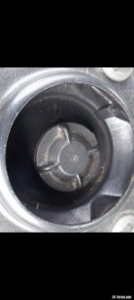

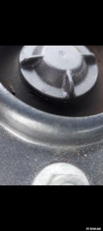

Here you go
You could see the cracks in the rubber: new one is headed the same way too so new ones on order!
I should have mentioned, the OSF had a broken spring, so that and the top mount were done co-incedentally (or not) just before the knocking started.
The NSF does have a couple of small splits, but the OSF that was done looks a little different. The rubber seems to sit much deeper/lower.
