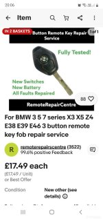

Used this Guy on ebay. Key was fixed programmed and back in 2 days . Offers a complete key service . All reviews good as well.
