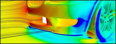

I thought it would be good to share a project I have been working on. Although very beautiful I have always felt the Z4M styling could do with a little more aggression, especially the front. I decided to design and develop my own splitter and canards for more of a CSL/GTS appearance. Having been able to reverse engineer the car over the last year with use of photogrammetry I am approaching the development slightly differently by utilising computational fluid dynamics simulations. Below are two pictures of the reverse engineering model and the base CFD simulation
So far I have run three different splitter iterations and got up to 12 kg more downforce at 180 km/h.
The design will keep evolving for aesthetic reasons and to try and extract more aerodynamic performance out of it. Next up is the first simulation of the canards. I would be great if you could share your feedback, experiences and thoughts!
