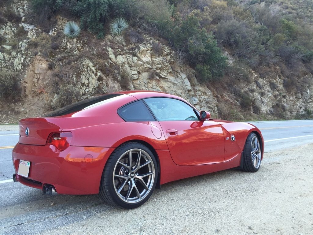

275/30-19 is actually about half an inch smaller in diameter than the OE 255/40-18. So, your car's rear end body is about 1/4" lower to the ground and you have gained about 1/4" in wheel well gap (space between top of tire and fender). The increased wheel well gap illusion makes it look "taller".
I had noticed the same thing when I swapped out my OE wheels/tires with 275/30-19. On my next set of tires, I'm going to see if I can stuff in some 285/30-19...we shall see :D
D4dawg said:
Hahah on what model and wheels buddy Ref 285
Currently running BBS CI-R 19x9.5et25 with Continental ExtremeContact DW 275/30R19 in the rear. On compression, it looks like I may have about 10mm clearance to fender/bumper and about the same on inside wheel well (stock camber). The 285 may work if and only if my next set would also be DWs. It may not work if I veered away from the DWs. Will decide when the time comes for new rubber

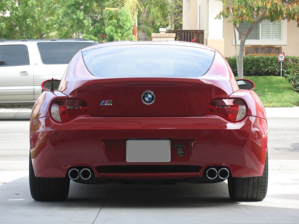

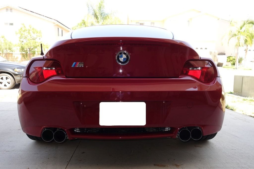

I have Eisenmann Sports on the car at the moment. I've gone through several, but settled on the Eisenmann. For your curiosity, here are a few comparison of my past exhausts in chronological order:
Painted Stock - Way too quiet. The high temp. black paint actually made it more presentable and hide the "man sacks"

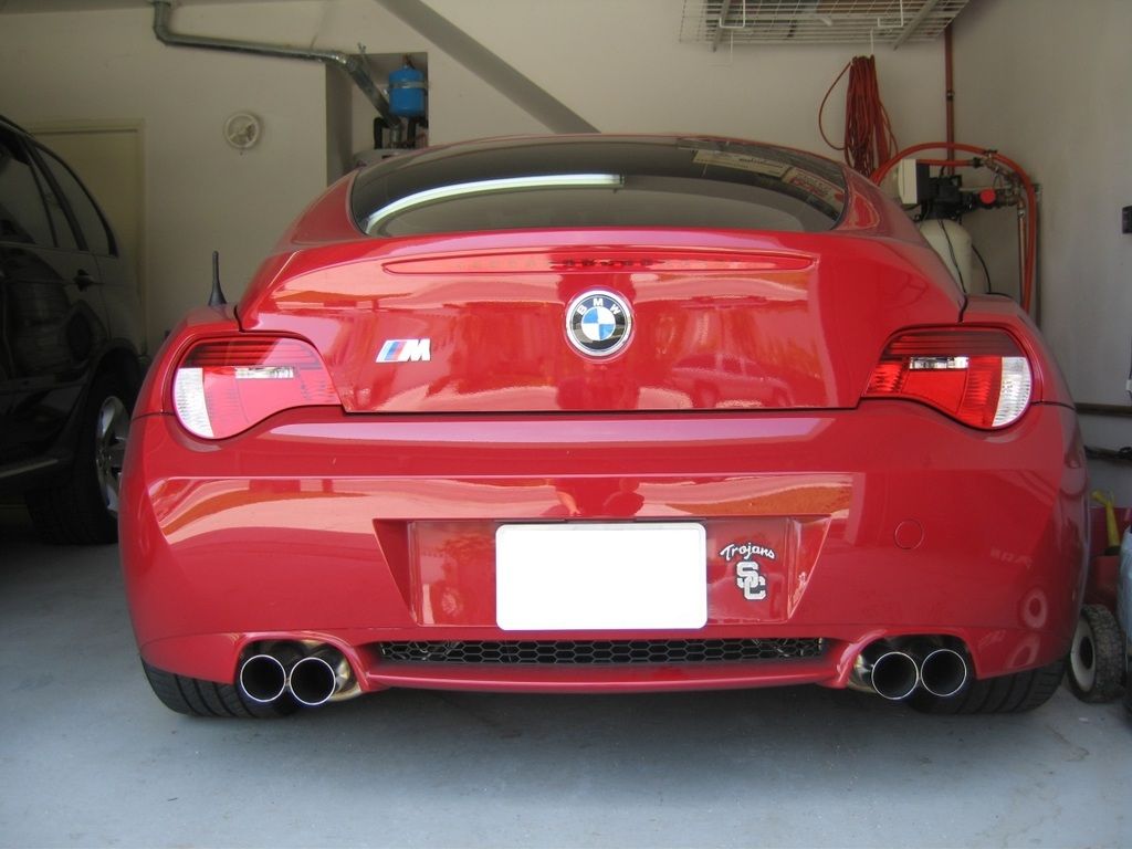

SuperSprint Race - Way too loud for street use. My neighbors hated me. Raised too much unneeded attentions driving around town. Took it off after a couple of weeks. The tips are not that much larger than stock, but protrude much more past the bumper
Remus Sports - Just a tad louder (I would say about 10% louder) than stock with a nice deep tone. Very nice finished tips.

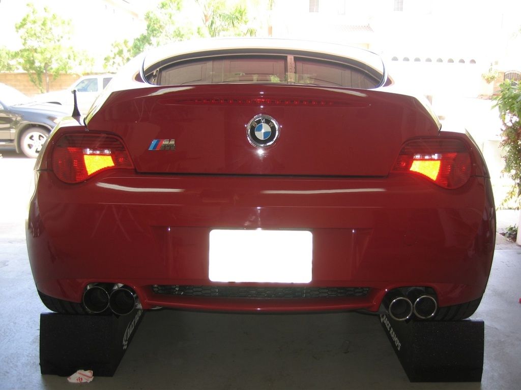

Remus vs Stock
Eisenmann Sports - Just a tad louder than the Remus, also with a good deep tone. Has the largest tips of all these exhausts (83mm). This is my good middle ground between stock and SuperSprint Race.
Eisenmann vs Remus
Nice write up xmetal...
Good idea painting the boxes black blends them in a bit better, far too big!
