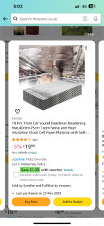

I always add sound deadening
Cheap from Amazon makes your door closing sound much better

darich said:
I guess with this stuff, you simply cut it to size and stick it to the inner skin of the door?
Yes thats it . See here https://z4-forum.com/forum/viewtopic.php?p=1501241#p1501241
