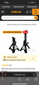

I assume these Uk draper versions are made in China ..pretty good..nice height reach
I’ve made these to test. If you dont here from me again then this is the reason.
I do have these though but most of us are UK based so wont help really 😂
