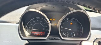

B bluepain Member Apr 8, 2026 #1 OK guys got all.these up today. Not had this many before Haven't read the codes yet ,I've misslaud my reader. Any thoughts
B21 Elite Scottish Borders Site Supporter Apr 8, 2026 #2 DSC / ABS failure probably due to a wheel sensor failure / broken connection…
enuff_zed Lifer Attleborough, Norfolk Apr 8, 2026 #3 Yup, with the tyre pressure one lit too that's almost certainly a wheel speed sensor. If the speedo still works it's not the rear left. A decent code reader will tell you exactly which one.
enuff_zed Lifer Attleborough, Norfolk Apr 8, 2026 #4 An oddity with the ABS/DSC system is that the more lights you have on, the simpler the fix.
B bluepain Member Apr 8, 2026 #6 Cheers guys that's what I suspected .. Mislaid my obd reader ..foolishly lent to someone me thinks but can't remember who
B bluepain Member May 12, 2026 #8 Front left wheel speed sensor was dead . New one fitted Back to black dash.. No yellow
