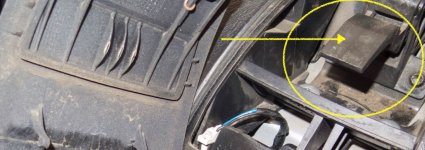

I may be in error here, but I think the door/button on the cover that that the OP is referencing, is the manual release for the manual soft top lock release (see attached pic) which is enabled/disabled with the central locking system. ...the larger cover (item 1) has a mechanical solenoid system (item 18 and or 10) attached to its backing that moves up and down to release that door latch.
my z4 (2006) does not have that lock and there was a plastic ring holding the solenoid plunger up to keep that door latch from opening - not sure if the soft top lock (circled in yellow) was only on earlier models, or just removed by previous owner (in my case)
therefore, it is my belief that if you do not have that soft top locking mechanism (circled in yellow) on yours, then the door latch in question is meant to be locked closed.
