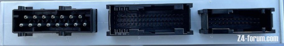

Might have found the culprit!!!
Now to find some electrical contact cleaner - thanks Colb.
I’ll update the forum once cleaned.
Owen
Owen
Is that the plug to the centre module?
Think I’d be looking for signs of moisture getting into the car too.
Hi,
Yes, that’s the connector to the SRS Module in the centre console.
I have only had the car two weeks, so suspect maybe someone may have left the roof down in the rain at some stage?
Everything else looks dry as a bone.
Thanks
Wow that was quite green wasn't it.
Looks like wqater got to it and set the green growing, I would suspect the module may have been fried hence no comms with it. If you can get it ultra clean then try communicationg it again if its still duff then source a compatable module as per Realoem site based on your Vin Number. Good luck with coding it to your car, it should communicate with the doners Vin in it but it will generate a Wrong Vin Number code until it is recoded to your car.
colb said:
I would suspect the module may have been fried hence no comms with it. If you can get it ultra clean then try communicationg it again if its still duff then source a compatible module as per Realoem site based on your Vin Number.
I have ordered an ECU 6939811 from eBay which should be with me tomorrow. The seller has kindly offered a full refund if the car doesn't communicate with it.
Removal of the gm5 module shows all contacts and connectors are clean, but have given them a liberal spray of contact cleaner just to be sure.
One step forward - two steps back!
Thought I had it cracked, replacement module detected by OBD2 diagnostics - hooray - proved my original module was faulty and I have a good K-bus - relief!
Backed up SIM85 module in NCS_Expert, went through the process of using WinKFP to code the VIN number to the car, however it went through the process of updating the part number at the same time - something I didn't expect and had to restore the code settings from the backup file as for some reason, after coding the VIN, several of the options in the trk file had changed.
Module is being detected okay, however, I still cannot reset the airbag light due to two errors: -
1. SRS Airbag - 93AC System time fault
2. 987B Coding, firing circuit, belt tensioner, rear left at variance.
On a plus point, and I hope it wasn't a waste of time, I have successfully installed the module in the centre console, there's 2 1/2 hours of my life I won't get back anytime soon.
Really need some help on this one now, when I was driving the car last week, there was no airbag light!
Thanks, Owen.
