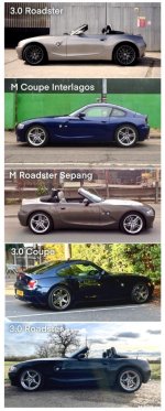

Going to tackle the MSport steering wheel refurb this weekend. In the meantime I’ve been recalling my Zed history…all loved, none forgotten :D
Start with a roadster, end with a roadster and just being unfaithful in between :lol:
