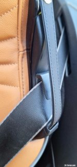

In the forum zroadster.com (German) a user has constructed some seatbelt adjustment, there known as, coat hook :)
He gave me the 3d files, so I resp. my colleague printed these coat hooks. Yesterday I sticked it in my car. Before:
After:
How it looks like:
First of all the disclaimer: Anyone can print and use the files private and the 'hook' at their own risk.
You can print it online or at your own 3d printer or where ever you want.
I tell you how I did it. You can do it however you want. A colleague printed it for me, the settings are the settings of his printer.
The 2-sided adhesive is from 3M, black, 20 mm with the p/n VHB-5952
The settings of the private 3d printer (you will find it on online 3d printing platforms as well):
PETG with carbon reinforcement (I don't know if this matters).
Printing method: Fdm print, layer thickness 0.1 to 0.2mm, inner strength 25%
Please send me a private message with your e-mail address and I will send you the 2 files and the paypal address for donation.
