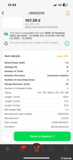

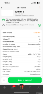

Thanks for this guide. I need to do the starter motor on mine, but I’m failing at the first hurdle in that there seem to be several listed as compatible with the e85 Z4 (2003 3.0).
These 2 are similarly priced and have the same output but seem to be different sizes. Can anyone give me a categorical answer on which one to buy? Many thanks.
