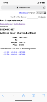

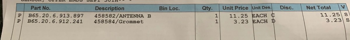

Being that age it might be a pita to get off.
I sheared the bolt that goes into the base when i did mine and mashed the old whipped aerial.
10gbp to replace the base.
Try some wd40 on it.
Yes, I gave up on mine. Just buy a new base and fit it. Not too hard, and you can polish the panel whilst it's off!
