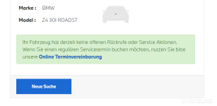

There is currently a campaign underway in Germany concerning vehicles fitted with the N52 engine. The 2x4 VANOS screws will be replaced by new ones. As there is no online translation, here are the translated texts. You need to enter the full chassis number and you will then see a result.
https://www.bmw.de/de/topics/service-zubehoer/bmw-service/rueckrufe.html
Recall actions relate to the safety or compliance with legal regulations of your vehicle. These actions are free of charge for you. If you have specific questions, please contact your BMW partner.
The safety of our customers and our products is very important to us. For this reason, the BMW Group carries out quality controls on an ongoing basis. You can check below using the 17-digit chassis number whether a recall is currently open for your vehicle.

I used the link and Google Translator did a great job. Until I entered my VIN and it didn't translate the response!
My 330i is a really early N52 as it was built in September 2005 - do you know if there was a start date for the recall?
Failing that can you tell me what this is in English? "Ihr Fahrzeug hat derzeit keine offenen Rückrufe oder Service Aktionen. Wenn Sie einen regulären Servicetermin buchen möchten, nutzen Sie bitte unsere".
Many thanks. :thumbsup:
Well, we assume that only 2010/2011 engines seem to be affected. But that is currently not ensured.
The result of the VIN check can be seen in my 2nd commented picture above.
Green is nothing to do. :?
My 2006 530i touring isn't affected as well.

Green is OK - Grey requires activity from you!
