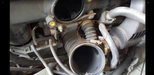

When taking out the DISA valve today, I've found this hose is perished & splitting.
I'm struggling to identify it in the parts lists. Is it item 5 in this list? It doesn't look to have enough outlets.
All I need is the part number, so I can order a new one.
Yes its the right part number. the 3.0 is different to the 2.2/2.5 ones as the 3.0 has the noise maker.

Its the pipe for the sound generator that pipes induction sound into the cabin.

I need to replace this item but did a quick repair on mine yesterday. Bit of Humbrol model glue on the splits (melts rubber and plastic together) then some insulation tape wrapped around the outside (temp fix).

Thank you. Not heard about the sound generator mod before and been reading up about it. I'll try removing the bulkhead foam from the pipe via the glove box end.

That's the piece that I removed,its a bit
Loud with both out.
Just wiggle the pipe out at bulk head and reverse to put back,one of the easiest mods you can do :driving:
