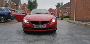

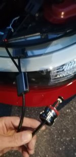

Hi Newbie here advice required ☺️ I've an angel eye out and need to replace. Owned the car near a week 😁 can't stop smiling.
Anyway
Has anyone any pros cons preferences to using the HID halogens or LEDs?
Currently has Led, 4 surface mounts 90 degree to each other which in my opinion doesn't look like an even brightness all the way round. The ballast bit gets really hot too.
Would a bright white halogen be better??
Il follow up with a picture give me 10 mins 😁
Gareth

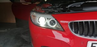

You have an aftermarket angel eye led mod in your hand there. Most people upgrade to LED as halogen originals are yellowish.
If its working ok leave it, you will find it illuminates the inner angel eye more than the outer. Personally I like this as the bonnet clips off the top of the inner angel eye and makes the car look like its angry!
As fior HID, only the outer headlight has a lamp in it, the inner is not used. HID do lose brightness over time, how old is your car?
To change the hid you remove a panel in the wheel arch forward of the road wheel.

I see you are in Hull, I grew up in Willerby, live in Plymouth now. I might be in Hull in a few weeks so pm me your phone number if you like...

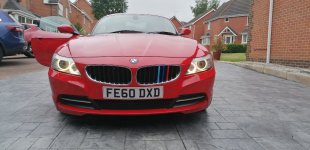

Thanks Mark it's 60 plate, yeah i think they look good now I see them in the dark
One is off though and I'll prob best replacing the pair then do you know what wattage that looks like by pics?

If I had a bright white halogen would that not be a better option if its a similar looking white/blue light and then it can be monitored too?
I tried using LEDs in the angel eyes but I really didn't like how only the inner ring was bright and even then it wasn't as bright as halogen bulbs. In the end I went for some white Osram bulbs (can't remember their exact name but I can look it up) although not as crisp white as LEDs I think they are alright and way whiter than the stock bulbs which are really very orange. Also they are brighter than the LED bulbs and both inner and outer ring shine fairly evenly:

I bought mine a while ago when I had my 23i, I swapped them to my 35i when I bought it. I am sure some of the guys who have bought recently can point you in the right directiom, just ask a new questin on the forum.
Yes leave the outer lamps alone, aftermarket LED headlamp bulbs are at best generally crap.

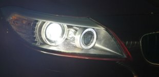

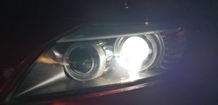

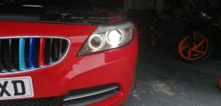

It's the red one mark, have u any pics of your 30i. Yeah I've only had a few plays with bimmercode it's my bosses for his i3 so I have to drive out to his everytime as its paired to his phone. I will invest in one if you've any recommendations.
I tried repairing the led driver today, peeled open the case and carefully removed the rubber epoxy to find none of the components were stuck to the pcb πŸ˜…its obviously run that hot its desoldered I assume, doesn't look like any current limiting designed in so it has a 5w resistor sucking in the current but you could fry an egg on it! Resoldered everything and it worked for about 10 mins and the led bulb then packed in lol. I think I'll avoid cheap Chinese ahem I mean aftermarket LEDs so I've replaced with cool blue halogens for angels and they look good just not quite as white.
I'm running out to bosses now I'm going to set the drls to without dipped beam so it's just the 2 rings. It does it for the coming home lights it looks good :thumbsup:
Aftermarket led
Halogen
Aftermarket led
Halogen
The resistor is there to replace the resistance of the original halogen bulbs filament. If you fit LED without it the car throws up a blown bulb error as it sees no resistence in the circuit.
Good leds come with a small box in the middle of the cable between the existing plug and the led which simulates the missing filament. They do get hot but it should not damage the casing, unless its a naked resistor and it was touching the case.

Wow I love it, 385bhp lol sounds lethal I bet she is bad :evil: and apologies 35i. Mines Rosie named by the last female owner ☺️ I've adopted it lol
That make sense why the resistors are there then but the check control for them was turned off anyway.
We def need a chin wag then sounds like your in the know for mechanical upgrades. I'm just enjoying driving it for now,. I've been bad and kept the m badges on but I'll get down to aesthetics next payday!
What's your thoughts for drl can't decide with or without main beam. I've been looking at the lci side indicators thinking maybe colour code them to the alloys? Though your chrome looks good :thumbsup:

They are the same Osram bulbs I have in mine. As you say not as white as the LEDS but they function better.
