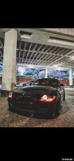

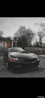

I managed to put mine on the inside edge of the light unit. There is a flat section which they can be adhered to. Therefore no cutting required and can be very quickly reverted back for MOT if needed👍

This is my install
