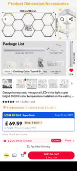

Ordered these a month back from AliExpress, 90 quid absolutely thrilled with them, they are mega bright too, so now my beautiful Coupe is chilling in its own little showroom on a carpet being lit up like a Christmas tree πŸ˜‚
If anyone is thinking of doing the same all I'll say is work from the middle out, and upgrade your lighting breaker in the fuse box because for some reason when you switch these on they pull a lot of power initially then run on hardly anything.
Well worth the wait and the effort πŸ‘ŒπŸ‘ŒπŸ‘Œ
Actually Β£69 my bad, plus postage obviously.
This setup fits nicely in a standard garage if anyone is interested πŸ‘πŸ‘

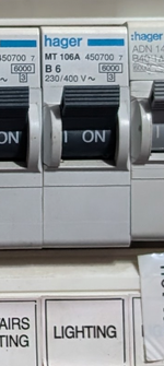

You should ONLY do that if you know you have a cable large enough. Lighting circuits are 6 amp in the UK (standard) with a minimum of 1.0mm2 cable wired to them. If you change the breaker to anything larger than 10 amp with a 1mm2 cable you risk overheating the cable and causing a fire.
If your lighting circuit wiring is 1.5mm2 (some are some are not) then you can increase the breaker to 16amp.
All are subject to how the wiring is routed, as different 'containment' and lengths of cable runs have different maximum amperages for a given cable size.
Basically, unless you know exactly what you are doing DO NOT increase breaker sizes just because you want to, or need to for the lighting connected to them.

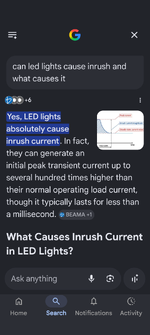

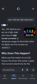

LEDs are not high load start (or shouldn't be).
