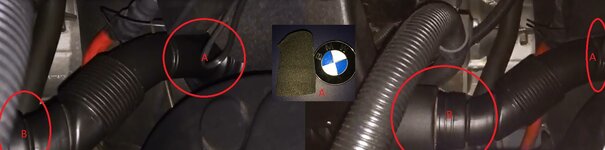

I was able to pull the tube out at the location marked A in the picture. The amount of foam that I pulled out from this side is shown in the middle next to the bmw badge. I was expecting a little bit more noise from removing this piece of foam, so now I would like to try removing the foam from the engine side.
Is the location marked B, the correct location of what I need to pull out? Ive tried pulling/twisting/etc the tube at the location marked B, but I cant get it out. The tutorial found in the DIY thread has pictures but the engine side of the soundgen looks different than mine.

There is a jubilee clip shown there, and mine does not have that. Also the tube above looks different than my tube.
Any help would be appreciated so I can figure out how to remove this 2nd piece of foam. Thanks

so far I've driven it with the (A) side piece of foam out for a few days, and definitely want to try it with both out, and then with (B) out, but (A) in. i've seen some people say that the (B) side foam is more dense, so taking that out but leaving the (A) in is just the right amount of noise. right now the (A) out/(B) in, isnt cutting it for me.
my main problem is that I dont know how to get to the (B) foam from my pictures. my tube looks different than the others that ive found from searching. am hoping someone can confirm that the (B) in my pictures is what i need to pull out, or if its somewhere else i need to be looking.
Foam is definately in positions a and b. I did find pulling it away from b position was quite difficult, need a bit of confidence and would check there are no clips underneath the tube holding it in place
Mine didn't have a jubilee clip on it either... but was relatively easy to remove from both sides.
Noise-wise I am happy with both out. It's not my daily driver, so I can live with the noise and it's only really when you plant your foot.
Successfully got both pieces of foam out. Was expecting the engine side to be bigger and didnt expect much of a difference in sound...but damn I actually love it now with both out. :D
Top piece is from (A), bottom small piece is from (B)
