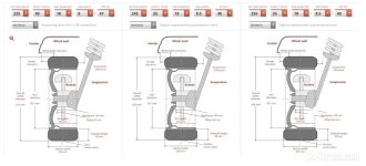

These are the diagrams Im getting back on the three tyre width fitments - 255, 245 and 235 - all at 35 and R18.
Differences to speedo and arch gap as per my list above.
The 235/35/18 are coming in at +2.49% speedo error and -7.75mm arch gap loss.
Oragne line = MV2 wheel size with 225’s - Green line = new tyre sizes
