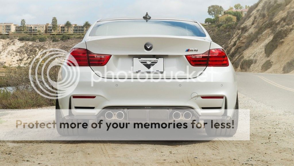

Have fun Jingle and hope all goes well. I have a rear bumper that I'm planning on modding because I want a quad rear exhaust mod doing and was thinking if it would be possible to move the exits in a bit on both sides...a bit like this....
But will have to see and check for room underneath
didnt get around to it this weekend due to time restraints :( BUT i did get my aero skirts on which ill put a pic up in my progress thread and take some better 1s.
hoping to do the rear bumper when the pdc loom comes, and want to do the front 1 evening this week after work depending on weather (hopefully tomorrow)
RE: the bumper in the pic above.... i dont think there will the room, theres barely enough room for a quad splitting into a V (rather than the forum favorite T along inside of bumper) so i very much doubt that would work above, hopefully u can figure something out when u have a look tho
