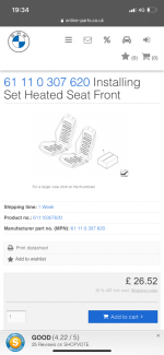

Ok quick update jus had a email and said there giving me a refund as part isn’t available :cry: so done some more digging have found a loom available it’s the e90 loom does anyone know if u can make this loom work or will it be a completely different loom

61120398203
Looking at this link there are various images to help us decipher the e90 wiring diagram against the one you already have. It's russian but Chrome will translate it.
https://www.drive2.ru/l/467274575814591459/
I suspect you will need to adapt a couple of connectors etc. but ultimately, it is just wires....
